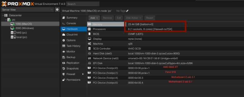

2. On Proxmox, Windows and MasOS run together.
1. install the os to new SSD.
Install File
https://www.proxmox.com/en/downloads/category/iso-images-pve
How to video:
Proxmox is not easy for who don't know anything about the virtualization.
i will share my proxmox setup commend for the passtrıght GPU and pci card to directly Virtual Machines.

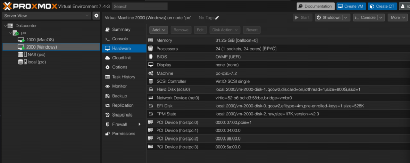

here is my proxmox screenshots
1144102454_EkranResmi2023-03-3123_08_27.thumb.png.5c80e8254b812f71dba4a393a7c3a1e9.png
501436408_EkranResmi2023-03-3123_07_57.thumb.png.2d7e1774e60a2c51d6ae2c7e82dfd2ce.png

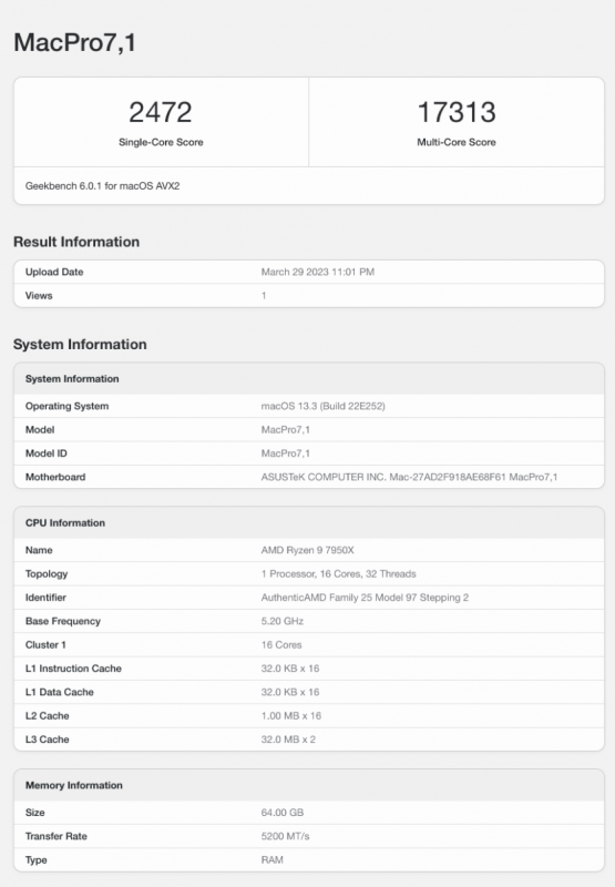

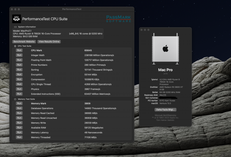

  • Cross Finger 1
Dude thank you su much. you are awesome.
work: except from sound EVERYTHING. (including airdrop wifi bluetooth iCloud FaceTime iMessage)
OMG i have huge monster now 😄
now I have to replace my 6600 xt to 6950xt (if it work weryvell?)
also have to replace my m2 with like yours.
thank u again.

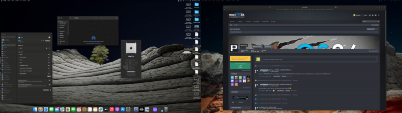

I use 2 4k monitor together. works like a charm
thank you again dude.
