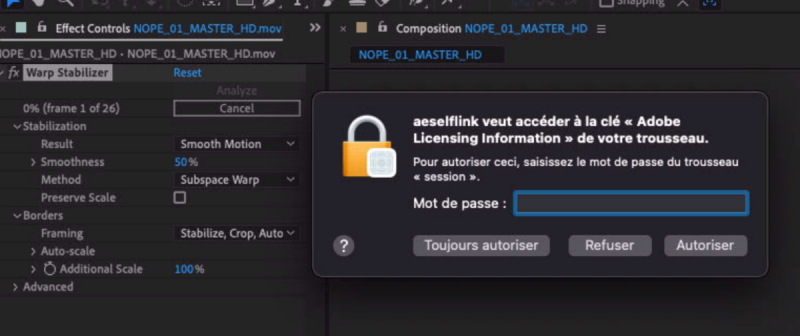

Hi guys,
Thanks for your work here.
I've installed the files for After Effects 22.1.1 with Big Sur, worked well, but since I've uploaded to Monterey it seems not to work anymore.
WarpStabilizer doesn't seems to work ( make crash AE and stop Puget Benchmark at this step )
Do you have any idea of the issue ?
Thanks

Wow, that's a fast reply ! 🙂
I've re-sign the app but since macOS always ask me to authorize After Effects process like aeselflink. Even I select " always ", the pop-up bring back a few times.
There is no real crash, After Effects does not start the analysing sequence for Warp Stabilizer. When I clic to cancel, the app frozen.
About the log, there are empty...
Link to post
Try this
with after effects closed
go to the executable path of stabilizer bundle
right click on it and open it
then close all window and reopen after effects and re test the warp stabilizer
it is not a patch problem
it seems a user permissions problems
Link to post

Ok sorry for the noob question but where I can find the WarpStabilizer bundle ? when I do a research into the AE application content I can't find it 😬
EDIT : Nevermind, it was indeed a permission issue as you suggest. I've fully uninstalled and re-installed Adobe Creative Cloud and AE, and it works well now. Looks like the Monterey upgrade have altered some files.
Thanks for your help
Edited by Darkpulse
Resolved
