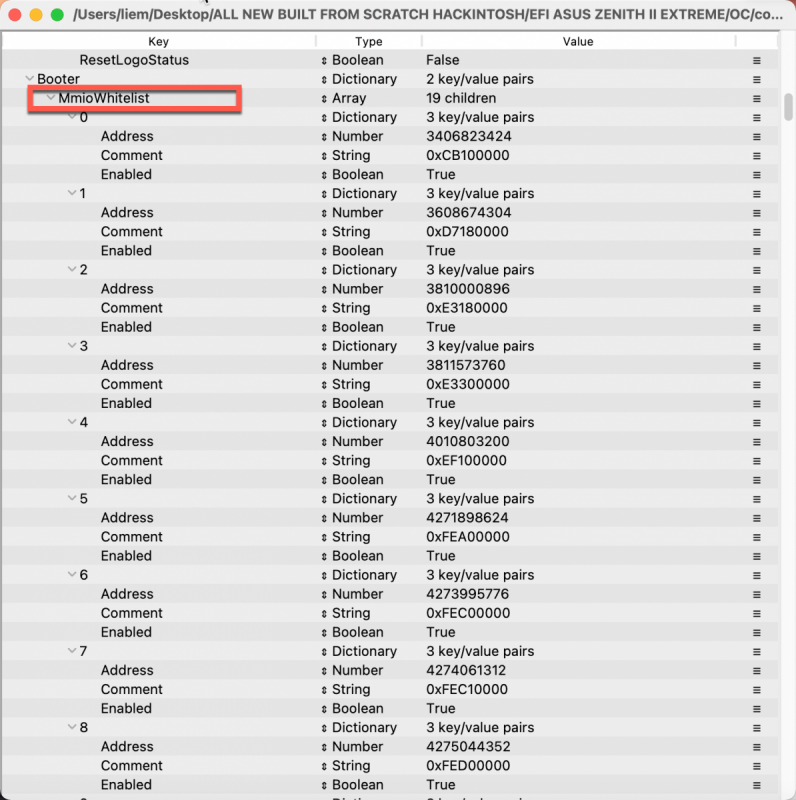

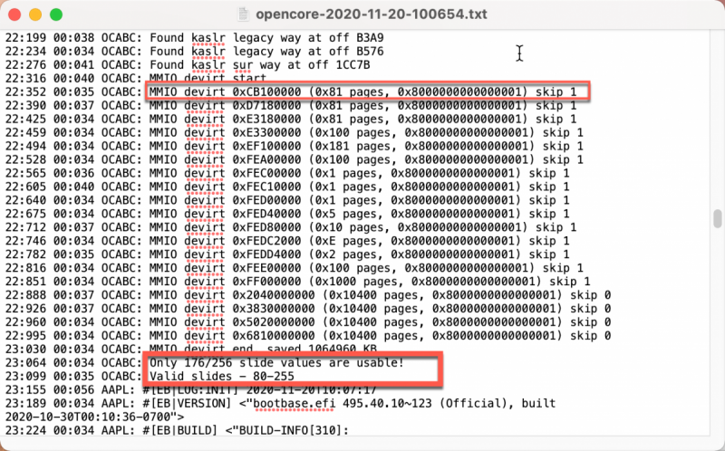

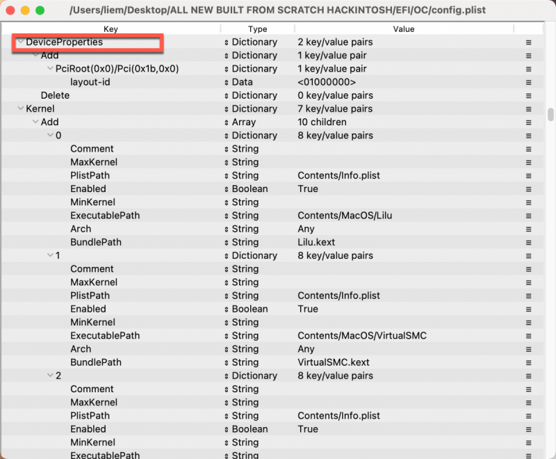

1. The MMIO, I know it's very important to edit the table with memory mapping, and following https://dortania.github.io/OpenCore-Install-Guide/extras/kaslr-fix.html#using-devirtualisemmio, I don't really understanding what am I doing, just be a follower, Could you please explain about this technically?

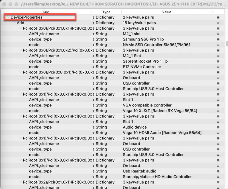

2. The Device Properties (config.plist), I have no ideas about this, in my config.plist, it's empty, but the config.plist sent from you, there's plenty of pci_(s), I know that it must be added manually, but I don't know where to get started, any advice will be much thankful and appreciated.

Regarding MMIOs, each motherboard has its own and even the same motherboard with a different Bios version can have different ones.
It is important to use and calculate your own and not to take those posted by other people.
The explanation is a little out of our thread and my knowledge, I can tell you that OSX writes on some parts of memory and it can happen that some devices do when used.
If these memory areas are not available for OSX, we have problems (ie kernel panic or other problems) for that we tend to where it is possible to give them back to OSX management by putting them to skip = 1)

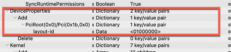

As for Device properties, I personally use an app that @Gengik84 is developing
Soon it will be available for everyone in our download area.
For the moment it is possible to use either systemsearch (an app in the download area) or Hackintool, an app that provides you with the plist to insert in your config.plist to get this:
1423901022_Screenshot2020-11-25at16_07_33.thumb.png.3f9e12909f912e036358239eef89b555.png

For the pci_ devices, I use Systemsearch (I didn't know it before because most of discussion in Italian😮,thanks to @Gengik84 for amazing app), I have the log file (attached) but I don't know how to put in the config, could you please give some hints.

@cleverhomedownload PowerTool app from our download area (always @Gengik84app) 🙂
see this videos to understand better:
compare also with my files:
txt files are from PowerTool save
plist is my device properties, you can check here how you have to name stuff 🙂
Pci Devices.txt.zip DeviceProperties.txt.zip my device.plist.zip

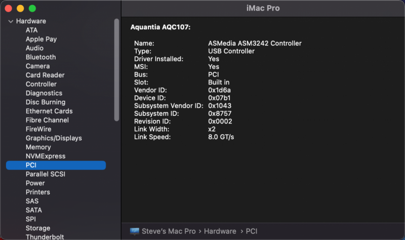

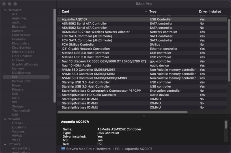

ASM1062 Sata is not loaded..have you tried to use some kext? like AHCPIunsupported.kext or similar for ASMEDIA SATA controllers?
I think some errors there..Aquantia should be an ethernet card..but..ei maybe I am wrong and you are learning by now 🙂 🙂

Not really I learned, I use Hackintool (the GUI is easier to use I guess), to export all pci_(s)  that detected from the current machine to a .plist, after that I complied it to DeviceProperties in the config.plist, that's why you can see some driver is not installed, and my 5700XT shown as Navi 10 [Radeon RX 5600 OEM/5600 XT / 5700/5700 XT].
Now, I'm going to find the driver for what not installed ( like this https://www.insanelymac.com/forum/topic/337363-3rd-party-sata-controller-marvell-asmedia/) and refine the descriptions (like Navi 10 [Radeon RX 5600 OEM/5600 XT / 5700/5700 XT] ===> Radeon RX 5700XT).of some thing that I surely know its name from Windows.
My problem is how to get its address? Is this their correct address? I'm not surely know😂, do you think is it OK?

1 minute ago, fabiosun said:
fiuuu it is hackintool
joking

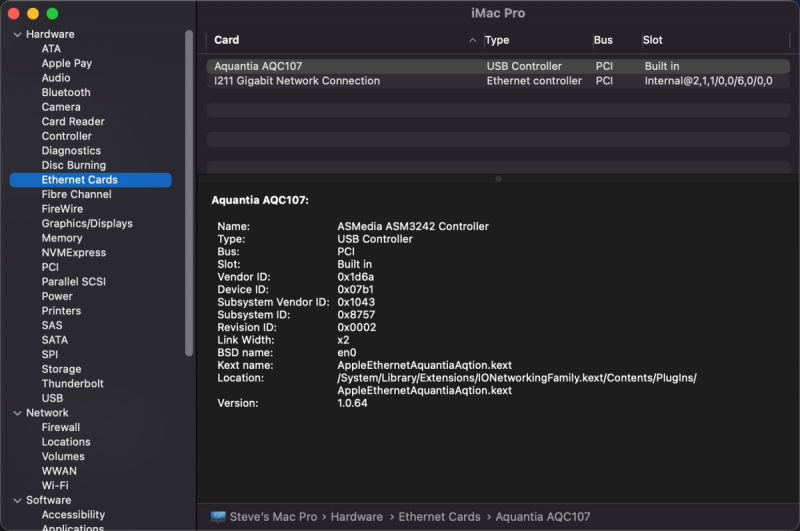

2020-11-26_00-05-58.png.9abfc479c7d79a4fa02d459ba6da8e5c.thumb.jpg.a56d9d85b7c150a4ad3e10c11c48e22e.jpg
this for me is wrong
I do not thing is an error of Hackintool
you have to check well

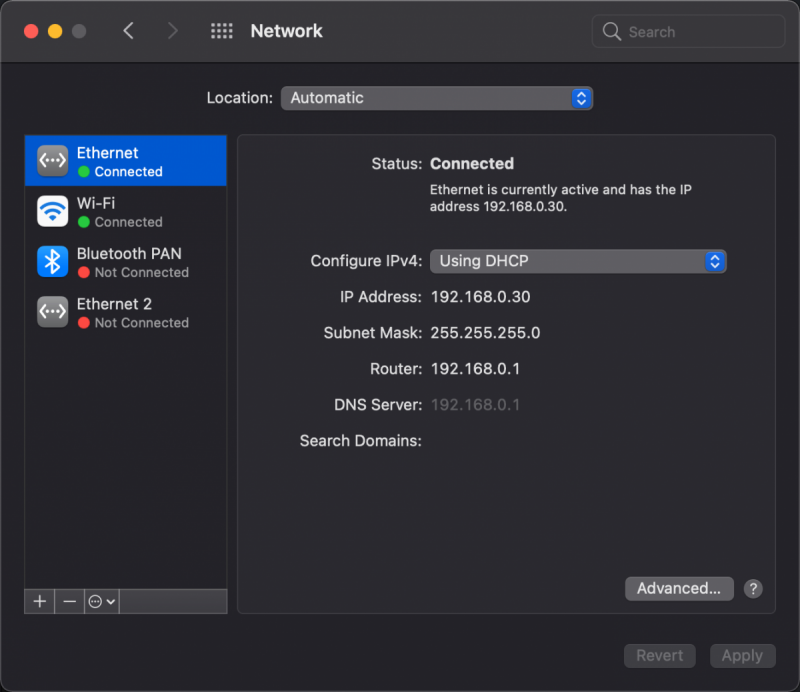

Getting nervous now, you are right, it must be Enthernet, but it show like this, and it's working, I plug the cable to its port (Aquantia) while sending this post😱😨
Or it seem like Apple implemented the kext for Aquantia card to make it work natively, no matter where it get connected?
try this, but you have too many stuff in device properties
backup your config before
