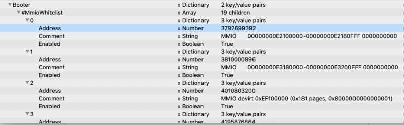

in my EFI
put # in front my mmio (MMIO is related to bios and motherboard manufactured ) you have to use yours
you can find it in your debug txt on the EFI root
try to start as I have said and see
3 minutes ago, fabiosun said:
ok, today our forum is a bit laggy..so it is difficult to interact well (it is in a maintenance )
in my EFI
I need to buy you guys Pizzas for all the help so far ! haha
I can't seem to find MMIO in config. I used the one on the 1st page
if you are using mine
flag here
then put smbios proper data (file MLB SMUUID and so on)

8 minutes ago, fabiosun said:
then put here complete efi I would try to post a debug EFI to see if a log could help us and to find exact your mmio
