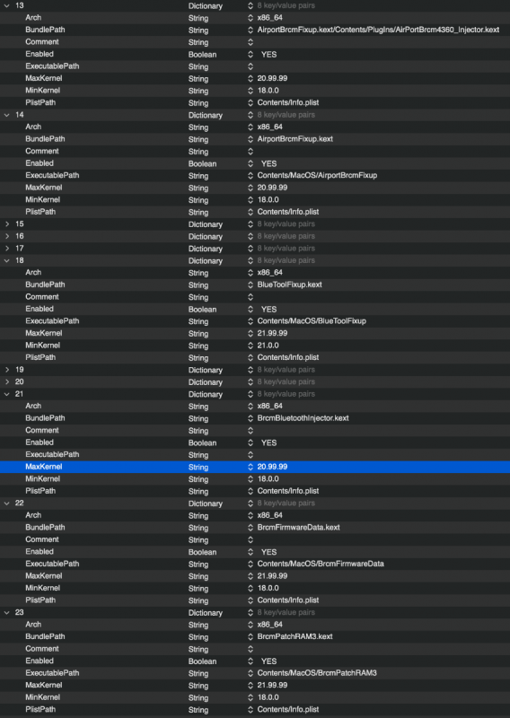

Ploddles Posted June 28, 2021 Share Posted June 28, 2021 16 hours ago, iGPU said: Supposedly, BlueToolFixup.kext is only needed for Monterey, and with Monterery you are NOT to use BrcmBluetoothInjector.kext. The image below may help to explain if you carefully note the version restrictions that I've prepared in anticipation of Monterey. Yes, that is what I was doing, getting things ready for Monterey, and I had set the Min & Max Kernel section for all 3 kexts, ie it wasn’t set to load the BluetoolFixup.kext with Big Sur. However the new IntelBluetoothFirmware.kext was halting the boot with a critical error. Replacing that kext with the old (v 1.1.2) one and I was back to normal. I’ll retry on the next update of these kexts. Link to comment Share on other sites More sharing options...
