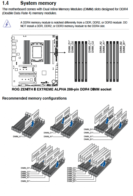

Note: this does not mean you physically move your DIMMs about on your mobo; this whole process is to map your DIMMs into software locations where the macOS is expecting them to be positioned. Keep your DIMMs physically where the mobo manual recommends.

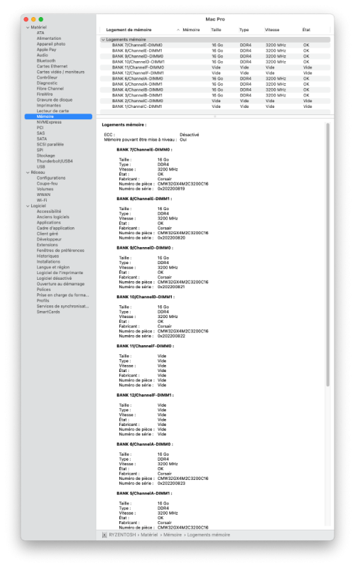

If SystemInformation is run, the following is seen:
1995963304_ScreenShot2021-05-01at12_18_02PM.thumb.png.e7f8e74e2c086bd0c4c9f83de96ba617.png

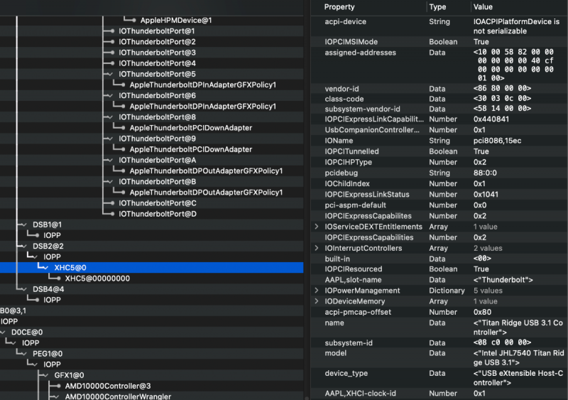

The other thing I've observed after changing to the MacPro7,1 SMBIO is that now the USB-C port on the TB card is present and active. However, when a USB-C drive is connected, it is not hot-pluggable but must be connected to the computer before booting in order to mount onto the desktop. The USB-C port did not show up, using the same SSDT, under iMacPro1,1.

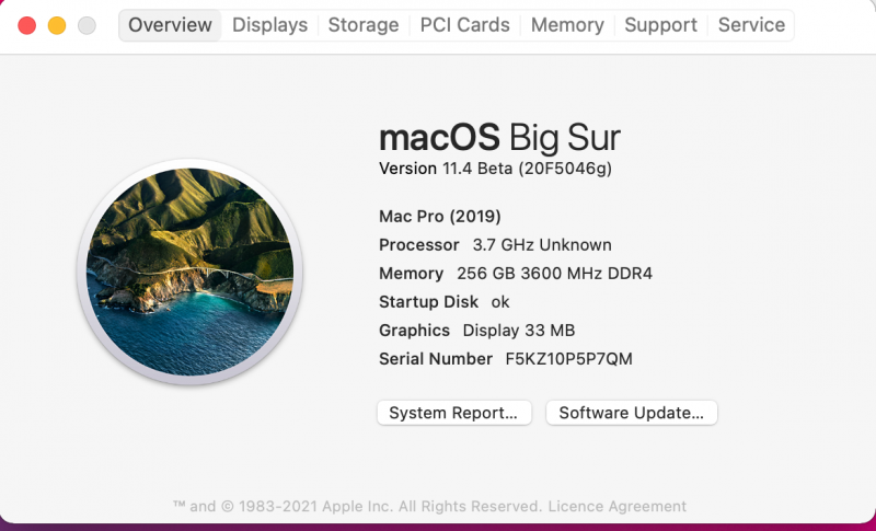

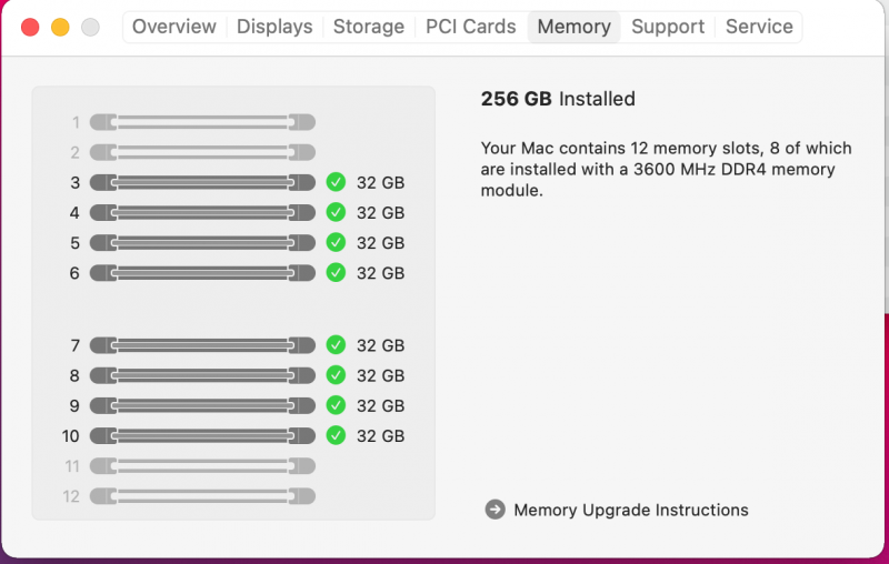

I got the memory error message when I logged in and it shows that the modules are on bank 3 5 8 and 10 😞 but the config you sent me looks correct with banks 4 6 7 and 9

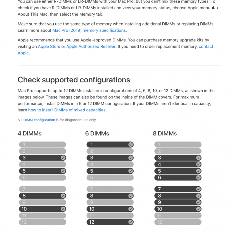

Now I'm really confused based on Apple configurations for the 2019  MACPRO the 4 DIMM configuration should be 3,5,8,10  which is what is showing on my build. 🤔
https://support.apple.com/en-us/HT210103?cid=macOS_UI_Memory_article_HT210103

As I wrote in my post, do NOT adjust or change your actual mobo DIMM configuration. This Memory section in OC simply shifts their location via software to where macOS wants them.
Don't worry about any of it as you are getting the correct image in the About Mac Memory window you show above (<-- I'm assuming this is your result and not one copied from fabiosun).
7 hours ago, Arrakis said:

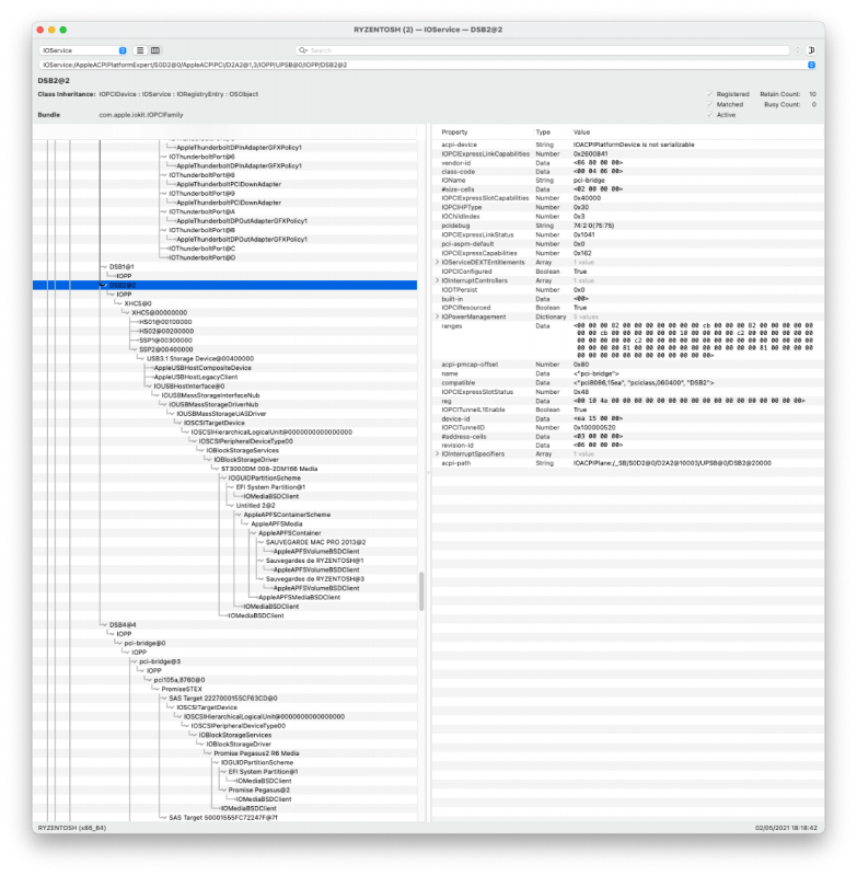

@iGPU
I hot plugged this docking station (USB C 3.1 Gen 2) to the Titan Ridge card, it works. I don't know if it's at the correct usb speed.
This looks great.
You've got hot-plugging because your mobo is better for TB than mine. I've added a TB AIC to a mobo that doesn't actually support it, so the functionality is a bit limited.
Edited by iGPU
