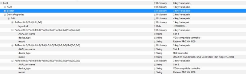

Thank you Arrakis, my config.plist was already based on yours, minus the MMIOs, will give it a shot.  Another question. What is the device properties section (in the picture below) supposed to accomplishing? I normally delete it and the system seems to work anyway. Can it be used for excluding one  PCI slot? I am kind of tired of having to disconnect my 3080 every time I want to boot in MacOS. I could not find the proper way to do it using whatevergreen and neither with a DSDT file I receive on this forum.
