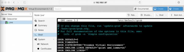

Due a problem with new TRX40 motherboard , ProxMox 6.1 and lower will hang on early booting stage.
To avoid this you have to modify grub.cfg file in this way:
find this line:
linux   /boot/vmlinuz-5.3.10-1-pve root=/dev/mapper/pve-root ro  quiet
with this
linux   /boot/vmlinuz-5.3.10-1-pve root=/dev/mapper/pve-root ro  quiet mce=off
adding mce=off allows us to start this exciting journey....
Alternatively you can modify this line directly on boot menu selection before selecting your choice (press E and add mce=off as shown before) thanks @KTC for pointing me in the right direction

Now pay attention..if you have not modified grub.cfg...you MUST do it now pressing E on keyboard and adding manually mce=off as previously shown.
You have also to remember to do it permanently when we start in Proxmox VE first time.

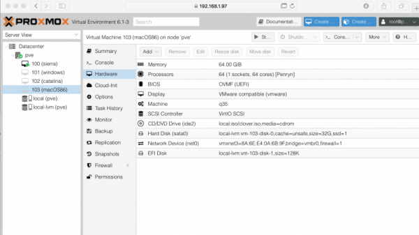

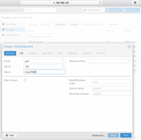

and now....Virtual machine creation.
1510184480_ScreenShot2020-04-01at3_49_58PM.thumb.png.1e368d59e455f4280eb72899e1efbfc8.png
Create button, start to fill all data in the same way I did.
Put a flag on Advanced, name your VM in my case macOS86 and go on
1822829602_ScreenShot2020-04-01at3_52_16PM.thumb.png.10ac77a3ce2f91e6ab42cf17ab474b36.png
choose local in Storage tab, clover.iso in ISO image and Other in Guest OS type, next.
Now important page (system) .
We come back here to the last part of this guide to configure GPU passthrough , for now in Graphic card us VMware compatible, in BIOS OVMF (UEFI) in Machine Q35 in storage local-lvm, then next Hard disk section.

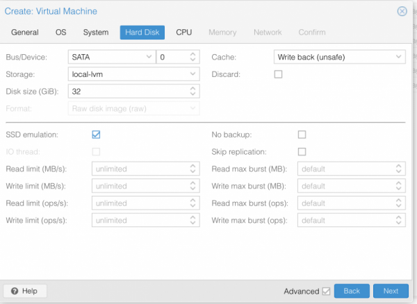

Here I have configured in a simple way, pretty similar to other guide, but it is possible to apply many solutions based on your skill to configure this beast...
Bus/device SATA cache write back Unsafe, Storage local-lvm, size 32 (as you want), flag on SSD emulation.
730676718_ScreenShot2020-04-01at4_01_24PM.thumb.png.725a627a245429bebcbbfeb8f76314ac.png

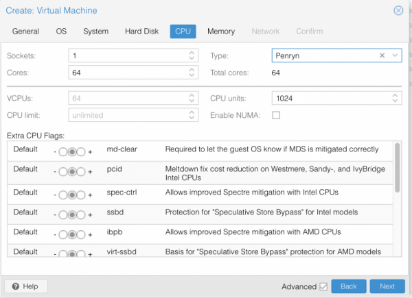

press next to go to CPU part.
In a VM cores and thread are the same (not sure but..hey..I am not an expert 😛 )
so fill as following image, Sockets 1, Cores 64, Type Penryn, flag on enable NUMA, leave default all other parts.
777499409_ScreenShot2020-04-01at4_05_35PM.thumb.png.76fca9c6fa1b81210a28e9e2588b02ed.png
You can also try others CPU type but no different results. In a  windows VM you can use Host as Processor type.
In OSX no! (not really true..we discover it later)

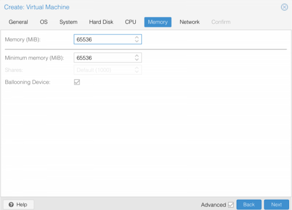

next to the memory part.
Here you define memory passed to th VM.
It is not possible to pass all memory to VM, in my case I can pass about 125 Gb*, in this VM I will use 64 GB (65536 Mb)
*less is better, now I am using 118 Gb
846745379_ScreenShot2020-04-01at4_09_40PM.thumb.png.bfdc35c049f4837562fd196f107ea001.png

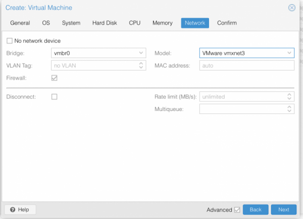

Next network part.
This is very important because it will be mandatory to complete Osx installation (if you use BaseSystem.dmg ReinstallOS method)
I use for now VMware vmxnet3 and leave the rest as is.
1495370456_ScreenShot2020-04-01at4_13_50PM.thumb.png.1273c51e6207ffd4e06805f85dbb4234.png
next step review all your selections in confirm tab and If all is ok finish it.

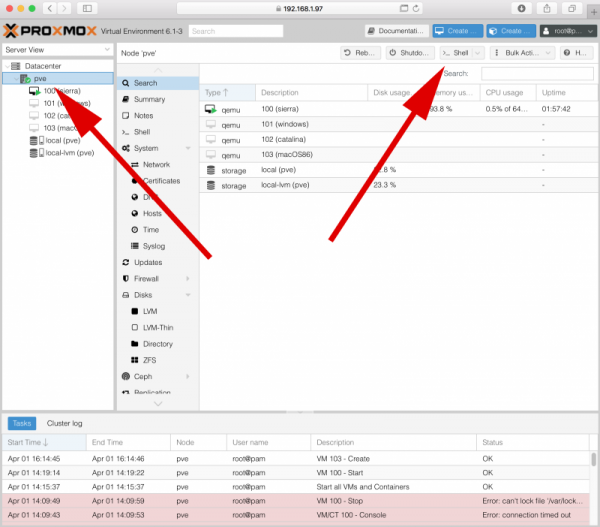

Now we have to modify some stuff in a terminal shell so click on node and to shell as shown in this following pictures:
2061745965_ScreenShot2020-04-01at4_18_16PM.thumb.png.d98cee734befb04dfd8078c93cc339a4.png

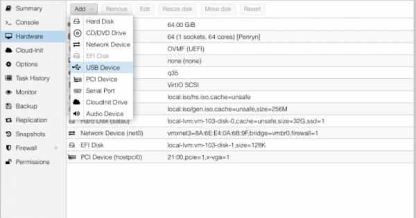

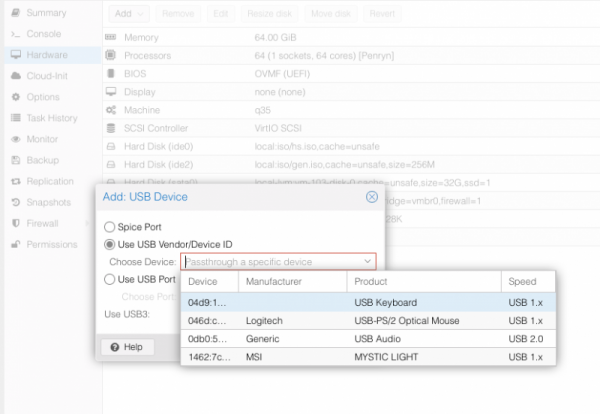

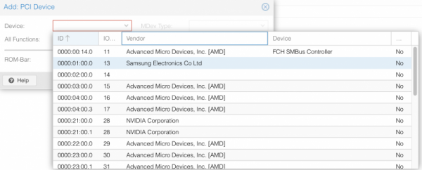

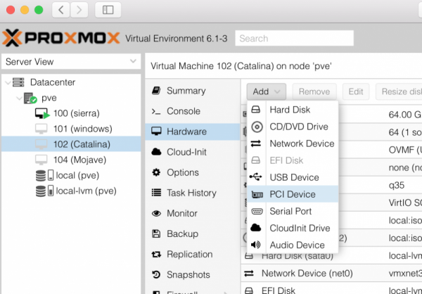

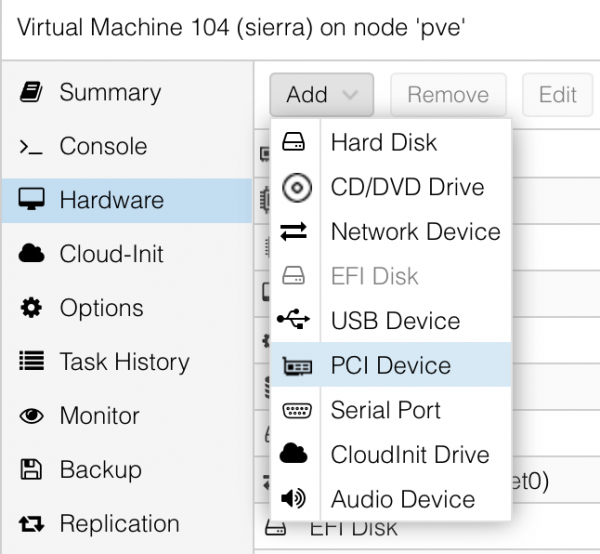

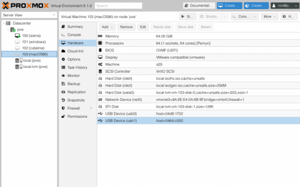

now we have to passthrough our keyboard and mouse (I have it connected via USB port)
In hardware tab select add and see following pictures:
2111867368_ScreenShot2020-04-01at5_28_05PM.thumb.png.0c42e67502f3afa7402c7244c6f453a3.png
170200438_ScreenShot2020-04-01at5_28_26PM.thumb.png.365ce4a145b74aaf469647de3fa4fad1.png
do the same for usb mouse.
Important note:
disable USB 3 flag otherwise usb are not working for this

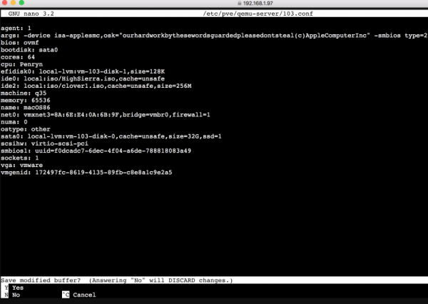

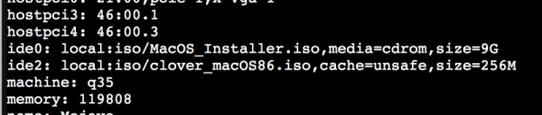

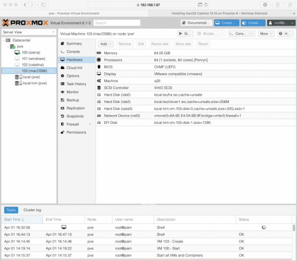

now..the linux part of VM creation.

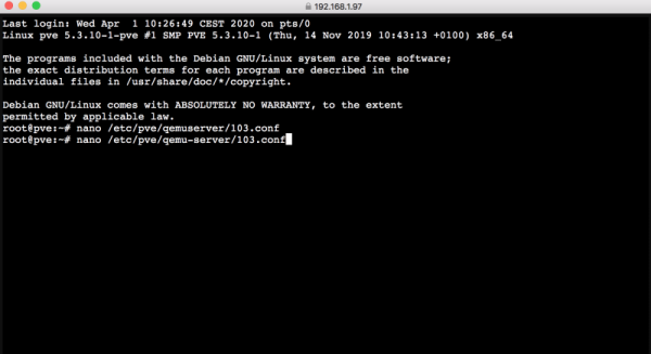

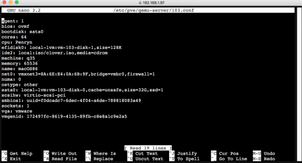

We have to modify manually some part of our VM configuration files and this is stored in /etc/pve/qemu-server/<VM id>.conf file.
We have to add as boot arg OSK key and other cpu features not present in old Penryn CPU.
So, open a shell:
1053774805_ScreenShot2020-04-01at4_36_08PM.thumb.png.895f6ac16d2df20e851d1b55d35f4a79.png
I repeat myself, node name for me is pve, VM id is 103..for your system could be different.
you wìll have:
1329530108_ScreenShot2020-04-01at4_43_36PM.thumb.png.9b3b2e4c88a87e4736e65e9a257e16dd.png
now insert this: (Nicholas Sherlock's site)
args: -device isa-applesmc,osk="ourhardworkbythesewordsguardedpleasedontsteal(c)AppleComputerInc" -smbios type=2 -cpu Penryn,kvm=on,vendor=GenuineIntel,+kvm_pv_unhalt,+kvm_pv_eoi,+invtsc,vmware-cpuid-freq=on,+pcid,+ssse3,+sse4.2,+popcnt,+avx,+aes,+xsave,+xsaveopt,check -device usb-kbd,bus=ehci.0,port=2
then for a base system reinstall installation:
ide0: local:iso/hs.iso,cache=unsafe
ide2: local:iso/clover1.iso,cache=unsafe,size=256M
or to a full dowloaded iso installer (with the help of VM_Assistant:
ide0: local:iso/MacOS_Installer.iso,media=cdrom,size=9G
to have:
1643533048_ScreenShot2020-04-01at4_51_20PM.thumb.png.88d63ef120ab78b9ae5e8d3f6bafa991.png
or:
893363647_ScreenShot2020-04-25at17_35_54.thumb.png.b23c15aed63822c397d85fc3a181babd.png
to save press ctrl x / y return

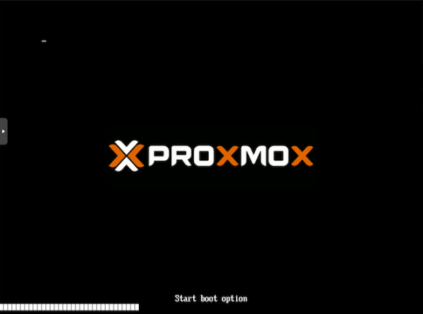

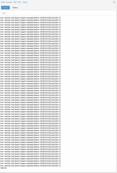

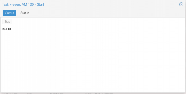

now you can select your vm and select Start.
550081446_ScreenShot2020-04-01at5_35_38PM.thumb.png.0b9e178b92aeea1abead8428d520162f.png

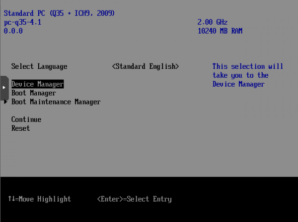

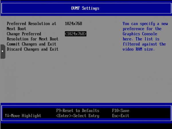

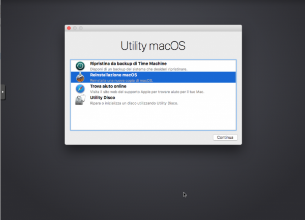

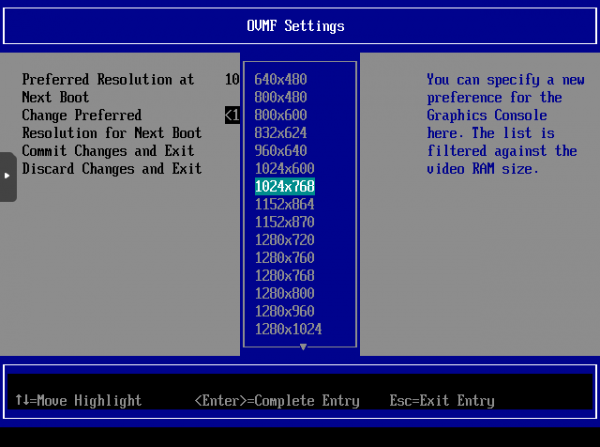

Now we have to do some basic stuff to have the chance to start an OSX VM.
Follow instructions here to do it simply  (Nicholas Sherlock's site):

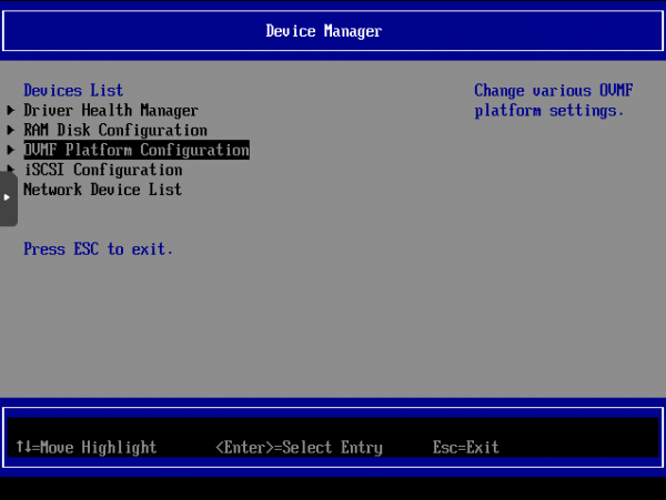

link to OVMF patch **
** In my system is possible to boot in the same way with clover or OpenCore, without patching this deb file

there is a bug , it produces on cold boot weird  video result .
Proxmox dev have solved this in a new commit!
https://forum.proxmox.com/threads/ovmf-screen-resolution-bug.55418/

In this part pay attention to screen resolution (we learn how to modify it if you have scrambling multiple resolution on your display )
You have to match config.plist resolution with OVMF bios resolution pressing F2 to key when you see Proxmox Ve logo on screen*
Added on April 9, 2020:
In opencore bootloader scrambling graphics is not present at all..so maybe it is a clover bootloader problem
press F2 here
then click on Device manager and choose:
Then verify if Preferred resolution at Next Boot and changed Preferred match.
If they do not match open selection and choose the same resolution:

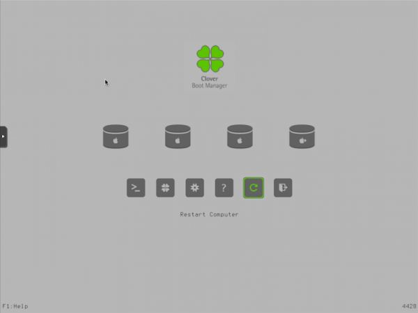

Then press F10 (save settings)
and commit changes.
Reset, now you should see clover boot menu
If you see scrambled test or resolution restart computer (clover button) and enter again the procedure above (Opencore solves this problem)
If all went fine you can start to install OSX.

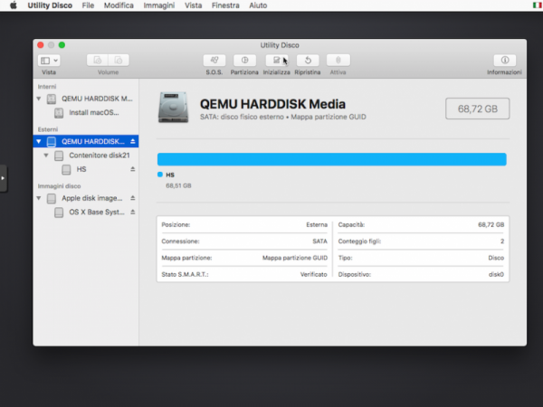

So select DiskUtility and format VM disk in usual way:
then close Disk Utility and start to instal/re-instal as usual
Here it is mandatory to have a working ethernet connection if you use reinstall option (base system.dmg based)
After some time system reboot and second steps of installation start.

to do this open a shell from Your Proxmox's web interface:
type nano /etc/default/grub
insert in it "amd_iommu=on" without quote as you see here:
884099881_ScreenShot2020-04-04at3_09_01PM.thumb.png.9ae800ae50b28c1198889dd673c466c6.png
ctrl x then Y to save
then do not launch upgrade-grub but pve-efiboot-tool refresh

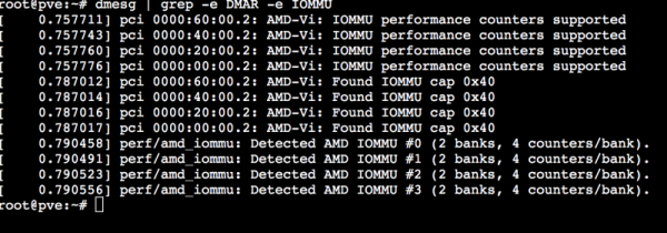

then reboot, to verify all is fine, open shell again and type:
dmesg | grep -e DMAR -e IOMMU
you have a pretty similar output if all is fine..otherwise repeat step above:
958380639_ScreenShot2020-04-04at3_13_17PM.thumb.png.d89ab4c527c77f0ac80c6e4ff0f654d4.png

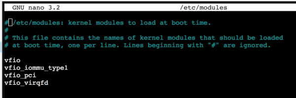

Now another very important part. We need some modules to load, by default they are not loaded:
type: nano /etc/modules and add these modules:
1737332577_ScreenShot2020-04-04at3_17_36PM.thumb.png.291c5d9e5b8f730a5ab41952d6e7959d.png

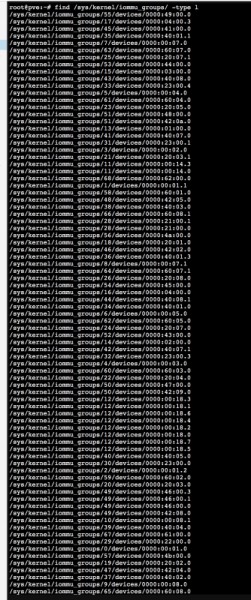

"Verify also IOMMU isolation (follow Proxmox wiki just in case) (follow my situation which may differ from your)"
1262758533_ScreenShot2020-04-04at3_19_26PM.thumb.png.bdebb0dc4d5739984ff77ab0c9b11fa6.png
"To have separate IOMMU groups, your processor needs to have support for a feature called ACS (Access Control Services)."

Note.. remember..we have set our VM bios in this way:
bios: ovmf
GFX need to be UEFI supported visit this link to understand other important stuff just in case:

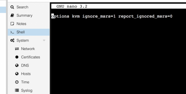

then to avoid some crashes add this line in kvm.conf:
echo "options kvm ignore_msrs=1" > /etc/modprobe.d/kvm.conf
also useful to avoid warning messages in your system log this:
echo "options kvm ignore_msrs=1 report_ignored_msrs=0" > /etc/modprobe.d/kvm.conf
as advice check always that command went fine in this way ie:
438356784_ScreenShot2020-04-04at3_41_17PM.thumb.png.ceaeb718f50dd3ecf926ccd6e656098d.png

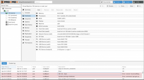

for now this is an important step, now we have to access to our previously vm created and add "The passthrough"
1189674024_ScreenShot2020-04-04at3_45_33PM.thumb.png.7ed3041c3640eb4a7833c99ddaec9a3b.png

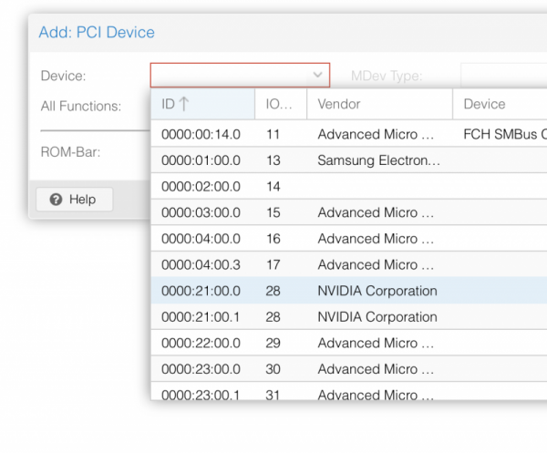

add PCI Device and choose your GFX:
441681135_ScreenShot2020-04-04at3_47_01PM.thumb.png.1ebd5c06bbb378c470ea23670e0037da.png
in my case it adds this:
300494242_ScreenShot2020-04-04at3_47_41PM.thumb.png.3f6d5ab3d287c8614e66d7be40812e55.png
and this is enough 😉

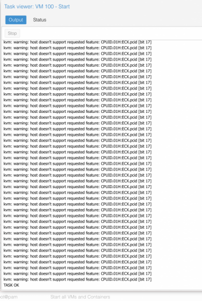

If you see only those two lines..launch your vm in your Web interface or via terminal command :
qm start 100
and see the log:
1522041564_ScreenShot2020-04-04at4_10_57PM.thumb.png.140442f9c33824e7b7ab3c09a701b9d4.png
this is good 🙂 (warning message disappear if you do no t use +pcid in VM conf boot args)
this no 😛
288050739_ScreenShot2020-04-04at4_11_42PM.thumb.png.6481c1ce99e57455a11f677f5419c239.png

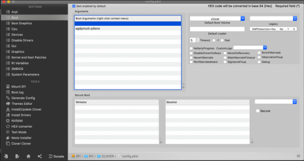

Additionally, I had to enable some extra flags in clover or it didn't boot correctly.
Make sure that you pass the agpmod=pikera boot argument. In graphics settings enable RadeonDeinit. Make sure that InjectATI is correctly disabled. If you are using clover configurator press the checkbox twice, otherwise it's enabled by default.
832135010_ScreenShot2020-04-24at18_30_33.thumb.png.619a397dbb1c4036341c8c891551595e.png
668329629_ScreenShot2020-04-24at18_31_05.thumb.png.55408b858a9e0fd793681d5a69dceee2.png

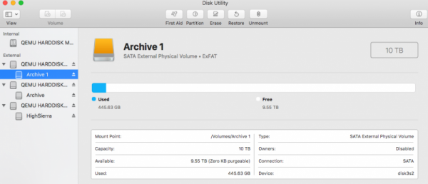

I would like to attach this disk, it is a windows disk formatted in exfat.
type this command using serial number you see above:
ls -l /dev/disk/by-id | grep ZA26YT4A
output in my case is:
root@pve:~# ls -l /dev/disk/by-id | grep ZA26YT4A
lrwxrwxrwx 1 root root  9 Apr  5 14:58 ata-ST10000VX0004-1ZE101_ZA26YT4A -> ../../sdd
lrwxrwxrwx 1 root root 10 Apr  5 14:58 ata-ST10000VX0004-1ZE101_ZA26YT4A-part1 -> ../../sdd1
lrwxrwxrwx 1 root root 10 Apr  5 14:58 ata-ST10000VX0004-1ZE101_ZA26YT4A-part2 -> ../../sdd2
now we can add it to our vm in this way, my VMid is 100, change the command for your id and disk:
qm set  100  -scsi2 /dev/disk/by-id/ata-ST10000VX0004-1ZE101_Z852YT4A
if all went as it have to be output will be:
update VM 100: -scsi2 /dev/disk/by-id/ata-ST10000VX0004-1ZE101_Z852YT4A
open from shell your VMID.conf, in my case 100.conf and you should see two pending operation (I renamed scsi2 to sata x.
Shutdown VM (no restart) and then start it again
In disk utility you have now your new attached disk.
265523403_ScreenShot2020-04-05at3_32_00PM.thumb.png.3e3510fefa3baeda40c8ea2086808234.png

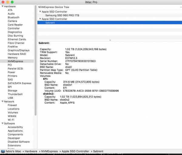

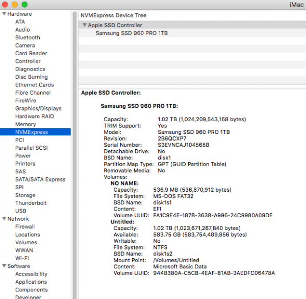

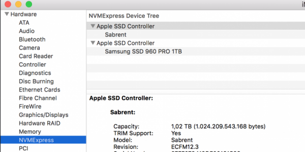

Passing completely NVME Samsung pro controller:
01:00.0 Non-Volatile memory controller [0108]: Samsung Electronics Co Ltd NVMe SSD Controller SM961/PM961 [144d:a804]
After rebooting we will have:
1528992384_ScreenShot2020-04-08at8_11_12PM.thumb.png.055f64d20431a8f8260ea19edddedfc2.png
In my case this one is a NTFS windows 10 drive..noew is it possible to use it also in OSX as usual

Now a tricky part if you are not confident as I am  not with linux..
If you have followed this guide you have (maybe ) a working VM and you are experimenting things..
One of the most important think in an OSX installation is bootloader EFI folder and its content.
Now when you upload bootloader iso files in Proxmox you have an iso extension but it is a sort of img file converted in iso, not accessible in a simple way, so, if you need to modify it or change something inside it is hard to achieve  (rebuild a proper Efi structure with @Kholia script or similar method with all things you need (ssdt, kext, efi drivers, config and so on adapted for your particular pc)

args: -device isa-applesmc,osk="ourhardworkbythesewordsguardedpleasedontsteal(c)AppleComputerInc" -smbios type=2 -cpu Penryn,kvm=on,vendor=GenuineIntel,+kvm_pv_unhalt,+kvm_pv_eoi,+invtsc,vmware-cpuid-freq=on,+ssse3,+sse4.2,+popcnt,+avx,+adx,+avx2,+bmi1,+bmi2,+fma,+f16c,+tsc_adjust,+tm,+tm2,+aes,+xsave,+xsaveopt,check
Boot args I am using now..I loose a little performance then before in Catalina..but I am not concentrated on it because my goal is High Sierra
109053933_ScreenShot2020-04-13at8_37_21PM.thumb.png.54f0ec870c062345afe659c69a85d034.png1753957805_ScreenShot2020-04-13at8_39_21PM.thumb.png.23c5ce7c147a6c0ec23f6ded478e260a.png

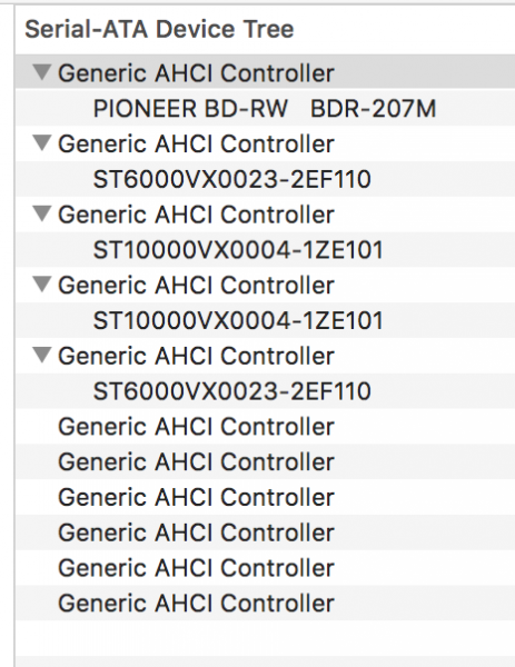

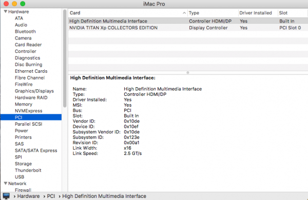

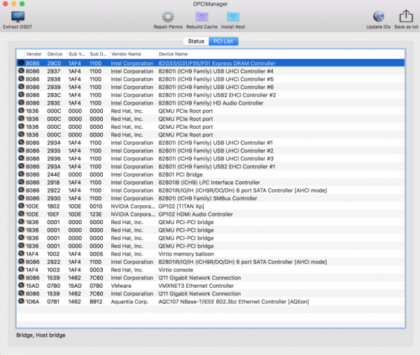

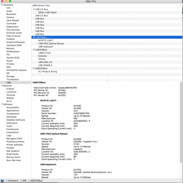

some words about PCI,USB and SATA passthrough.
Open a shell window in your host pc ant type lspci, you will have a similar list of useful data:

this is a short selection of groups and data you should see in your shell.
You can see USB controllers, audio controller, via controllers and so on
With web interface we have a graphical way to insert this important stuff to pass controller completely.
Web interface has a limitation..it is possible to pass only a limited number of  PCI controllersf.
It is simple to by pass this limit using shell editing.
Web interface add:
114549360_ScreenShot2020-04-14at2_28_31PM.thumb.png.ea7ea151db87681fca0fafff68cd5b8c.png
1601213102_ScreenShot2020-04-14at2_29_12PM.thumb.png.02452bcfe815ae5f68818f8eeaf09346.png
or to avoid 4 PCI limit also you can type in your linux shell:
root@pve:~# nano /etc/pve/qemu-server/100.conf
and you should see:
You can compare easily with previous data in my linux shell (lspci) and see my "passed" stuff for now...
This can work easily if groups are separated and well defined (search on Proxmox wiki for this), our new TRX40 shouldn't have many problems in this
another step reached:
Passed all except one USB controllers (ASmedia and two AMD one)
767808120_ScreenShot2020-04-14at7_35_01PM.thumb.png.f91c4d63323a64c4b597097fb7b27210.pngù
Also passed Intel lan and Aquantia, deleted in config net0:
vmxnet3=12:83:7D:28:45:26,bridge=vmbr0,firewall=1
2065975858_ScreenShot2020-04-14at4_46_02PM.thumb.png.c033484db0ba0fe5b0324a85b1f572a4.png

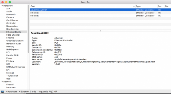

In this part we will deepen the passage of some peripherals integrated on motherboard such as the AQC107 NBase-T/IEEE 802.3bz Ethernet card and the two Intel Corporation I211 Gigabit network cards. The first one is directly supported by macOS HighSierra onwards. Instead for the Intel i211 a kext downloadable in the download section of our site will be used. Also download the dcpimanager application to verify that the ID of your network card is included in the same kext
Our initial friends as usual is Web interface shell.
Open it and type:
lspci
in the following part I will put only a useful selection for this part of the guide so I have to find network card useful data:
root@pve:~# lspci
44:00.0 Ethernet controller: Intel Corporation I211 Gigabit Network Connection (rev 03)
45:00.0 Ethernet controller: Intel Corporation I211 Gigabit Network Connection (rev 03)
49:00.0 Ethernet controller: Aquantia Corp. AQC107 NBase-T/IEEE 802.3bz Ethernet Controller [AQtion] (rev 02)
root@pve:~#
Now we can edit our VM config file and insert on it passthrough data:
hostpci6 49:00
#Aquantia
hostpci7 44:00
#I211 (first one)
hostpci7 45:00
#I211 (second one)
Save your config as usual (ctrl x--->y--->send)

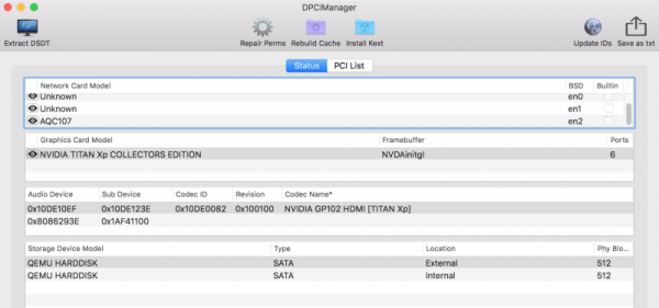

Before rebooting your System and relaunching modified VM, download i211 ethernet kext from here:
Insert it in your kext folder and, if you use OpenCore boot loader you have to declare it in config .plist
Close your VM and restart it again.
You should see in your system report all your Ethernet card available in your system.
2084675209_ScreenShot2020-04-14at4_46_02PM.png.4b53887d2d7a1e9b6659c28fcc6bca9e.thumb.png.1d6f719bc6aa0581a68dcc549ab26ac8.png

I have started using my NVME Sabrent disk as container of all VMs (VN files) and also for Proxmox installation.
Yesterday I have decided to do it better
Using a different disk for Proxmox and basic iso upload and passing completely to Vm my Nvme Sabrent to have a "vanilla" OSX High Sierra on it
So, I have formatted it and read again my guide to proceed in this task.
I have discovered many things , ie many parts of this guide could be skipped but I have decided to leave in place because maybe in different situations it could be useful to approach it in this way.
I noticed that I can boot easily without blocking and blacklisting many stuff..but it is advised in many "regular" guide to follow previous guideline so do as you think is better for your system.😂
So now I have a 840 pro ssd disk (256 Gb) for proxmox and clover/opencore iso
Sabrent NVme 1 Tb drive for a vanilla OSX installation.
why?
I do not believe this system could work better in a near future of this, if Apple does not insert in its kernel a proper AMD support..but if they will do I will have OSX as a real Mac has and I will update it to the next generation AMD OSX macOS 🙂
now some datas:
02:00.0 Non-Volatile memory controller: Phison Electronics Corporation E12 NVMe Controller (rev 01)
447484475_ScreenShot2020-04-23at10_31_03AM.thumb.png.eded83d1eaa1fab4308ceb3bc06dd993.png

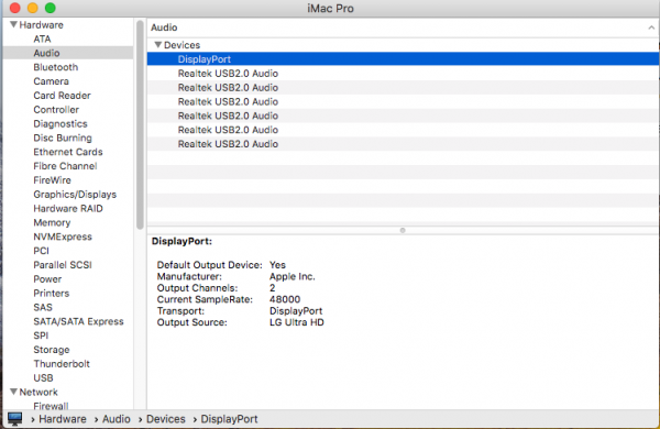

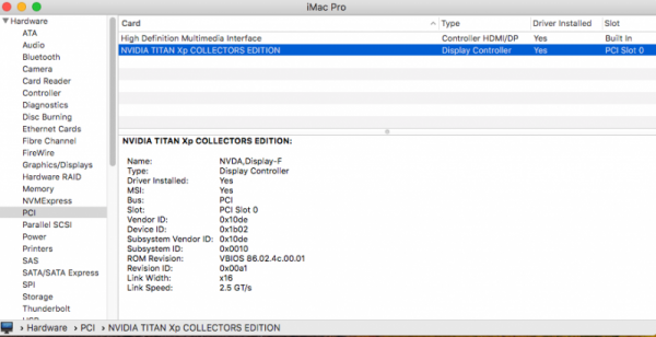

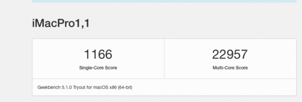

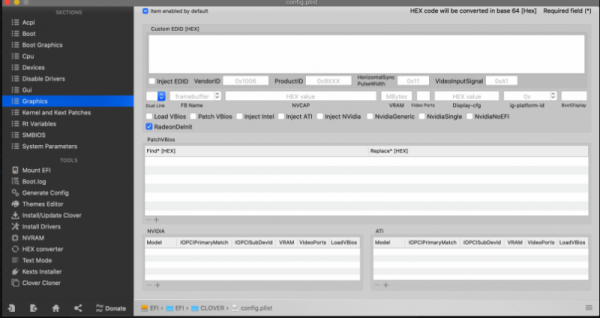

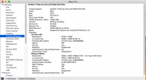

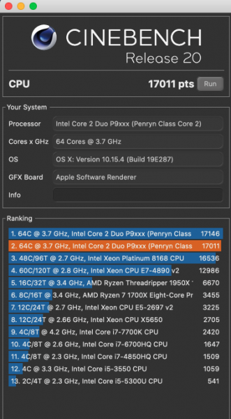

now I have this :
1955042951_ScreenShot2020-04-27at10_01_25.thumb.png.38a7166ec5b0c72749ffa99277a49fa1.png
152559322_ScreenShot2020-04-27at11_01_37.thumb.png.f81004cb344d62431c7f705989ec36f3.png
572366314_ScreenShot2020-04-27at11_02_05.thumb.png.4023dc8eb3a8fdf540acc8e9dda938e3.png
so no more qemu-drive (virtual disk on file present 😉
in my case no need to point to a bootx64.efi file in OVMF bios
